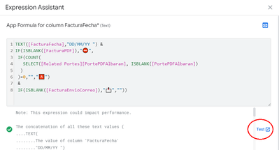

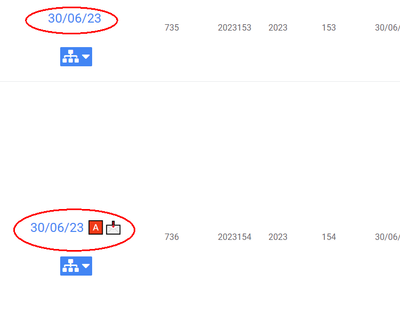

AppSheet has expressions that sometimes surprise you. (I just found out from jose_seddik that if a text expression is applied to a list, it automatically turns the list into chained text.)
Try to find a solution by combining the expressions:
Table[Column] - Get list with content of Column
SPLIT(text, delimiter) - Converts a text to a list
INTERSEC(list1, list2) - Returns a list with the common elements.
UPPER(text) - If instead of putting a text you put a List, it turns the List into a Text chaining its elements (separating them by , ) before converting everything to upper case
When you are editing a formula you can press the text button and check the result in each record.
