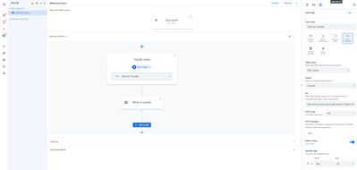

Failed Webhook type translation: Conversion error.
Hi, I'm trying to return a URL using webhooks + tinyurl api, but I get an error on the second process.
Any guess on this ?
The error message is :  Failed Webhook type translation: Conversion error.
I set my column type to Text, same for Specific Type (also tried with url)

In the automation it shows the shortened URL with the correct informations. I'm just trying to get that value inside a column
I made a ticket to the support but they said it seemed well configured and that it should work correctly -- it does not ๐Ÿ˜ž
@nico @Koichi_Tsuji can anybody help me with this please ?
The url inside the webhook is : http://tinyurl.com/api-create.php?url=https://form.jotform.com/231093511193348?codeChantier=<<[_THISROW].[column]>>

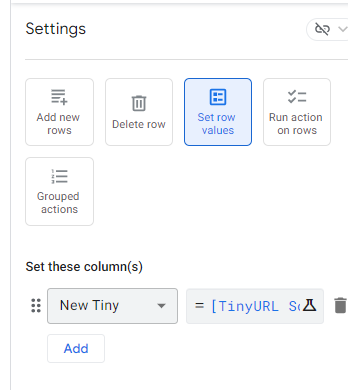

I think the problem is that in the Return Value, within the Specific type, you put Name: New Tiny and it matches the name of the column where you are going to save it later.
I have tested it and it works.
Try leaving the name of Specific type as Key (of type Text)and then assign New Tiny the formula [Tiny Solins].[Key]
