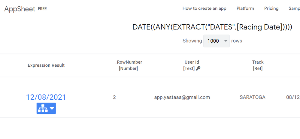

Having trouble to filter by Date. Have a table Entries that has to be Filtered by three columns [Track] [Date] [Race] .
No problem with the other two columns but with date, we cannot filter.
When i display the data of the slice the DAte is expressed as a Value.
In my data is with text format DD/MM/YYYY

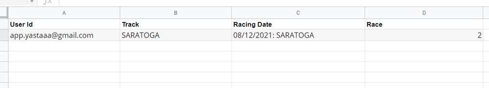

When i do filtering i have a column Racing Date that because of one reference One to Many brings a to column concatenate key instead of the date. So to solve that we created a virtual column for the filter with a formula to extract the date from as example : 8/12/2021
The formula DATE((ANY(EXTRACT(โ€œDATESโ€,[Racing Date])))) This is the Test result.
THe filter is not working. Could be that expression result must be a Date VAlue? If so.
What is the right expresion to convert a Date to a value date.

Usage of EXTRACT() is a bit overkill for your needs. Extract is meant to pull values(Dates in your case) out of a blob of text. [Racing Date] is already a Date so no need to use Extract.
First thing that jumps out at me is the date format. You want to be sure that all sources are using the same localization settings with regards to your dates.
Once this is established, there shouldnโ€™t be anything special you need to do to be able to compare or filter by dates
So far what you have shown is not a filter. Where are you trying to filter by Date? Can you show a screenshot of that expression so we can help fix it up?

I can not filter because the dates are stored or processed as Values (meaning numbers). So i need to convert the date extracted to a value (44419). Is it any expression for that?
I donโ€™t think the โ€œnumbersโ€ are the issue.

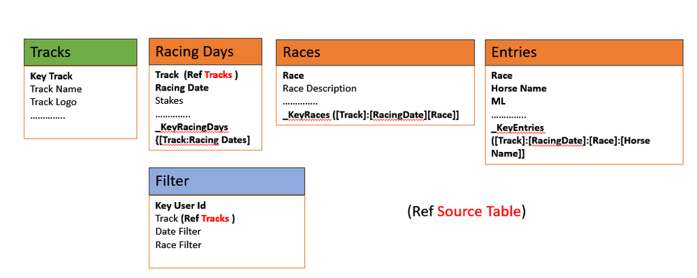

I am beginner but in my understanding . This is my guess shoud be the good practice.
I removed repeating the [Track] [Racing Date] [Race] in the child tables.
Racing Days is like the mother table with a CONCATENATE KEY _KeyRacingDays of [Track] [Racing Dates]
To create reference i have added virtual columns with the expression REFROWS to the Key of the Mother Table in the Child Table. I.E. REF_ROWS(โ€œRacing Daysโ€, โ€œ_KeyRacingDaysโ€)
Your table diagram is great. But it doesnโ€™t seem to show all the key values so Iโ€™m not clear on the relationships.

If your relationships are created correctly, AppSheet will automatically create these โ€œRelatedโ€ virtual columns for you.
Maybe because i started from a different structure from google sheets those relationships were not created automatically.

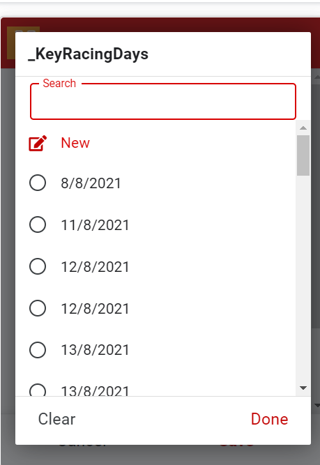

One of the problems people may face with this aproach is when you create this structure when you create a form to add races you will have problems to identify the Track and the Date.
The Dropdown will bring only the date column of the concatenate key.

Actually the value shown in the dropdown is controlled by a property on the table called "Labelโ€™. You are seeing only the Date because it is marked as the Label column. Switch it to your concatenated column, and those values will be shown instead. See image below where to find the Label property.
NOTE: You can only have a single column marked as the labelโ€ฆUNLESS you are also including a column with an image. In that case the Image is shown first and then the second data value column is shown.

Yes. In a concatenated field, EXTRACT() works great to pull out the date portion from the text blob. But your expression above was using [Racing Date] directly. No need for EXTRACT here - that value is already a date.

This thing happen when you mark two columns as label.
This thing happen when you mark the key and is hidden.
So to correct this mark the key as label and remove the other ticked as label, make sure of this. Edit the key columm and tick Show? Then everything will be Ok.
Right. the only time you can mark two columns as Label is if one of them is an Image. then the image is shown first followed by the value of the second column.
Labels cannot be hidden. They are what is intended to be displayed instead of the Key column value
