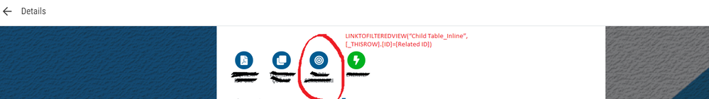

Problem adding records in filtered view with LINKTOFILTEREDVIEW
LINKTOFILTEREDVIEW(“Related Child Table”, [Related ID] = [_THISROW].[Related ID])
In this way, I was adding a record to the child table under the main table, but there is a problem, the related id is not recorded. Is there a problem with it?

Previously, I was able to switch to the filtered child table with a button and add records. Currently, I cannot bring the ID of the parent table to the child table as a column. The record is added but does not appear under the main table.
When I add directly from the bottom of the main table without using LINKTOFILTEREDVIEW, this problem does not exist.
also there is no slice and child table has parent table reference column. It didn’t have a problem until recently.
I still don’t know what you’re describing, but why are you not just using LINKTOFORM() ?
I am viewing the filtered child table with the button I marked in the main table
When I record on the filtered child table, it records, but it is not displayed because the id of the reference table could not be transferred to the relevant column.
There was no problem before.

I guess I didn’t explain the problem. There was no problem before, now when adding records to the inline table I filtered with “LINKTOFILTEREDVIEW”, the added record is not displayed because the id of the main table is not added.
There is no error in this formula, so the problem is why record is not added to the filtered id in record insertion.
Since there are too many child tables connected to the main table, I was hiding it and using it by filtering it with a LINKTOFILTEREDVIEW button.
