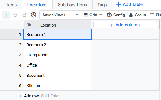

Hello.  I'm creating a home inventory.  I have a table called "Rooms" with a column called "Location."  Rows in this table are things like "Basement" and "Living Room."

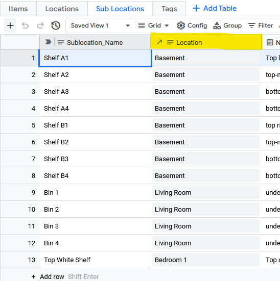

I have another table called Sub Locations.  This has rows with names such as "Shelf A2" and "Bin 1."  It has a column that references the "Rooms" table so that each sub location is tied to a location.

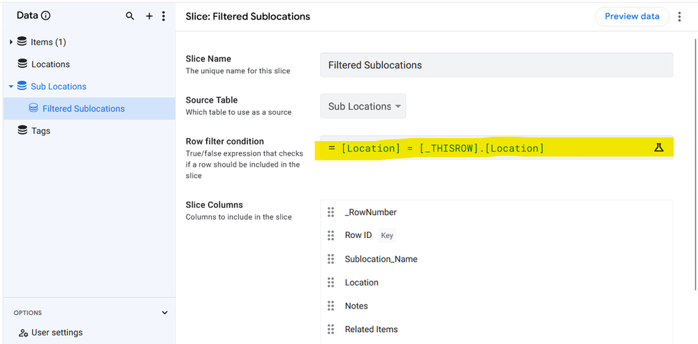

I created a slice that I think should accomplish this:
Here is the view of the Rooms (Locations).
From this view, I'd like to be able to click on a location and navigate to a filtered list of Sub Locations linked to that Location.  I tried to do this by creating a slice of the Sub Locations table with the following condition:

If my understanding is right, you are trying to get the list of sub location linked with the current row location. Data which should be shown is from Sub location table.
Remove the row filter condition in the slice. Use this expression in the linktofilteredview()
LINKTOFILTEREDVIEW(sub location view, ( in( [Sub location column], select (rooms[ sub location],[location] = [_thisrow].[location])) )
Note : make necessary correction in the names of column and table.
