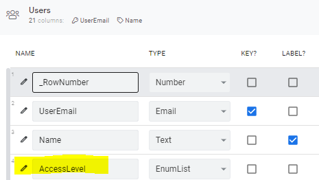

Table : Users
List of users, with column [AccessLevel] set this way:
  • Type: EnumList,
  • Base Type: Ref,
  • Referenced table name: MenuView

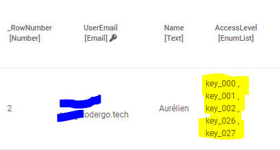

What I see at evaluating data from my Table Users:
This is a result of the enumList I ticked

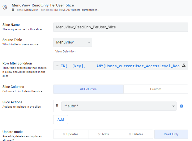

MenuView_ReadOnly_PerUser_Slice
Another slice, less basic but not so complex:
with expression:
IN(
  [key],
	ANY(Users_currentUser_AccessLevel_ReadOnly_Slice[AccessLevel])
And the result is the same.
