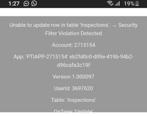

Hi, we are also facing the same issue
Account ID: 2715154
See errorerror.jfif
Updated. Please let me know if you still see issues. Thanks!
