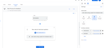

please have look in below screenshots which I have given to Mr. @Tommy62 reply. request you to give solution.
Sorry Mr. @AleksiAlkio , I have configured the bot incorrectly.  which has lead to error in the automation. Now it has been fix . bot works perfectly.
