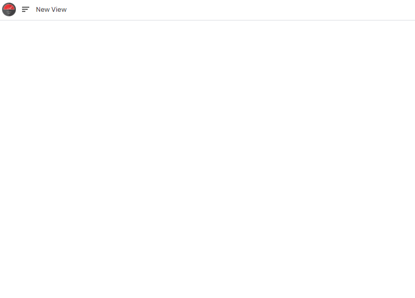

In App it comes out blank:

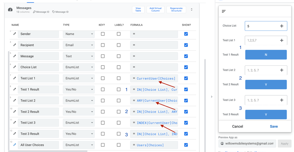

This didn’t mesh with my understanding , so I have been playing with various ways to access an EnumList of Ref’s. The behavior seems completely as I would expect. I am not seeing the issues highlighted here.
In the Image below, I am showing a Form where I have chosen a REF value into an EnumList and then used that in 3 different versions of an IN function (labeled 1, 2, 3). To help show the complete function, I am also showing the resulting Lists compared to (red arrows). I am aware you can’t see all details.
You will note that when I compare against CurrentUser[Choices], the test fails as indicated with a result of N. The other two tests, which pick off the first item from the CurrentUser[Choices] list Pass the test as indicated with a result = Y.
I’d also like to call your attention to the list results for Test List 1 and Test List 2. Notice how Test List 1 has NO spaces while the other Test Lists DO have spaces included? This is how AppSheet is distinguishing the list items. Test List 1 is a List of 1 item also a list. Test List 2 and Test List 3 are both a list of 4 items of distinct values.
Point is that the use of ANY and INDEX seem to work as expected without the need for CONCATENATE and SPLIT.
Example of List of Lists - Multiple list items. Note the placement of spaces to distinguish List items as lists
Here is a Mind Blower!!
It appears that the IN function WILL compare Lists against other Lists!!! And more over, the order of the chosen list doesn’t matter!!
In my Choice List, I have chosen multiple REF items and in reverse order of the lists I am comparing against. In all 3 variations of the test, the returned result was Y. Test 1 Result returned Y this time because its result matched the single list item of {1,2,5,7] though it is in reverse order.
The other 2 tests matched a list against a list.
If I then only choose 7 and 1, in that order. Test Result 1 is N as expected but the other 2 are still Y - compared list against list.
Choose a mix in lists and not in lists - all three fail - as expected
Choose none in common among lists - all 3 fail - as expected

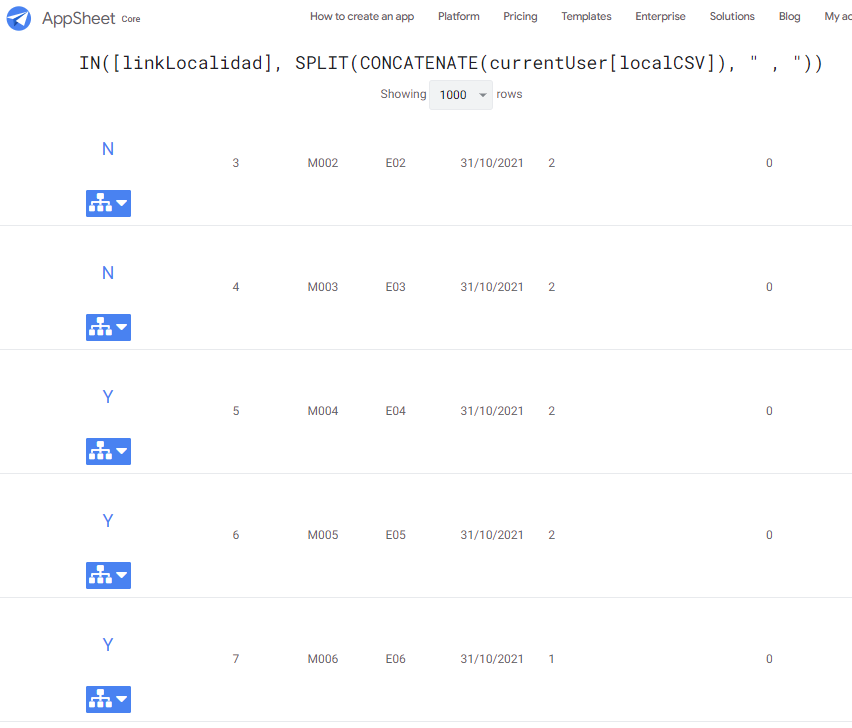

in([linkLocalidad], Split(Concatenate(currentUser[localCSV]), " , "))
This did it!! I guess there’s something going on with how the App works out the expression on the device.
Thank you to all that stopped by.
Now it works perfecto on editor test and app:

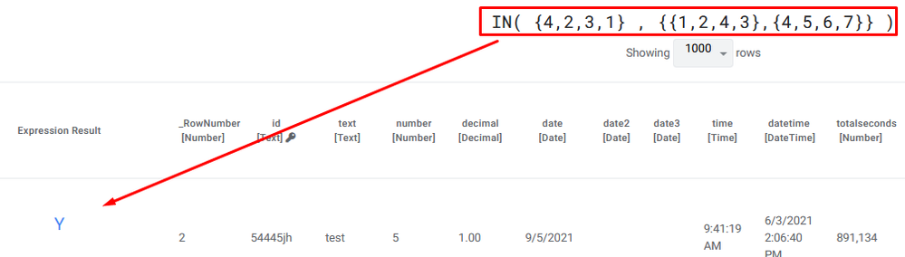

So, I discovered a weird oddity/bug today that has to do with some things discussed here.
Assuming the question is “how do I compare a value against a List of Lists”, and we have a Table “table” with a List type column “list_col”, do we use:
  1. IN( [value] , table[list_col] )
or:
  1. IN( [value] , SPLIT(TEXT( table[list_col] ) , " , " ) )
I’m quite sure that #1 did NOT work in the past, and you had to use #2. However it does seem that #1 works today, at least in most cases.
What I found today was a complex edge-case where #1 was still not working. I’m far too tired right now to explain in more detail, but for now just take this as my recommendation to:
Always use #2.
