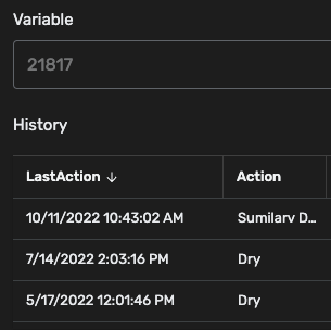

(And here's the current output, which is incorrect):
Thanks, Steve. I always value your contributions.
I gave those fixes a try, but unfortunately it's performing the same way.  Not sure if there is more info I can provide. I assumed the problem was somewhere in my attempt to count a filtered reference and divide into another filtered reference...
For illustration, here's a "3 out of 4 times were dry" scenario that I want to give me a "75%" but is outputting 100%.

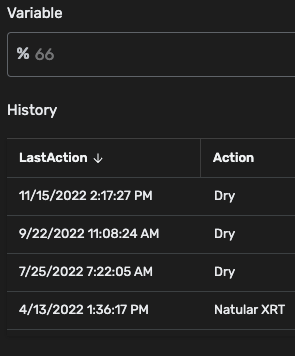

Thank you. That seems to have gotten me closer? At least I'm getting different numbers now, but the math is still not working out...This one in the screenshot should be another "75%", but is showing as 66%...
This is strange.
This one should be 100%...

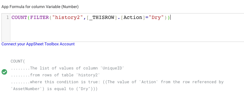

I removed the division part and just tried to get a count of all the "dry" for a given row. Its still giving me (what I assume) is the total count of ALL "dry" for the whole table...
I also tried it without "_THISROW"...
Yes of course it is giving a count for the entire table, you haven't told it to do otherwise. Is it a parent-child ref situation? If so, instead of FILTER(table...) you can do SELECT( [Related table][key-column]...)
