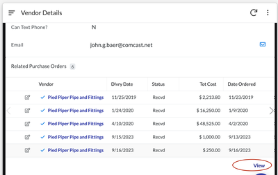

Yes, you can do this using the CONTEXT() function to hide the Inline table button from a specific view.  Below is an example where I hide the Add button from the "Related Purchase Orders" list in the Vendor Detail view.  See image below
NOTE: make sure you are changing the correct Add button!  Since the inline table below is a list of Purchase Orders, I want to hide the Purchase Order Add button

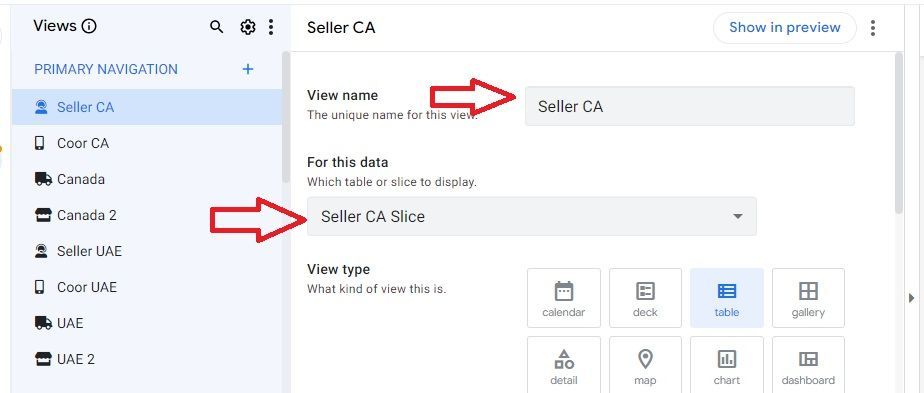

Hi @WillowMobileSys
My view is called (seller Ca)
I used this but still no solution
CONTEXT("VIEW") <> "seller Ca"
