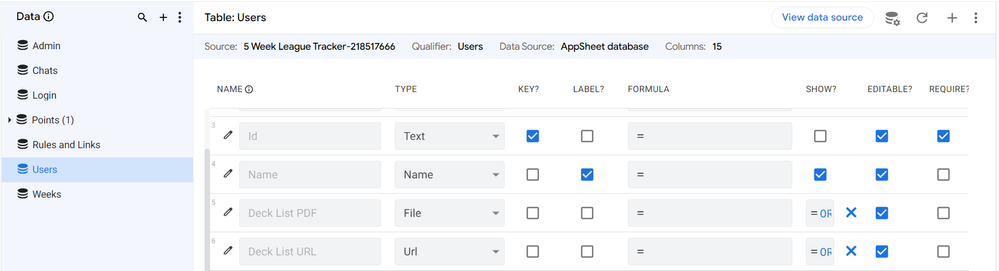

Here is a screen capture of available columns and Databases

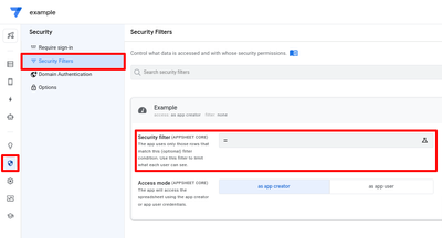

You need to use Security Filter. Formula would be something like IN(USEREMAIL(),LIST("admin@domsin.com",[User Email]))
Thanks all, I did put in a security filter and added a Admin table with just my information however a signed in user can still see all the links. Please see the pictures and let me know if there is other information you need.
Background: Creating a MTG budget league and I need users to be able to upload their decklists. However their decklists should only be viewed by the user who uploaded and the admin, myself. Currently anything shared is able to be viewed by all users. Screenshot 2024-09-28 094544.pngScreenshot 2024-09-28 094431.png
Not a security filter:
Ok, I found it in the link you provided under the Users Own Data. Do I have it in the wrong location?
Here:
I looked over the docs on security filters. They need some work. @lizlynch, I submitted some comments.

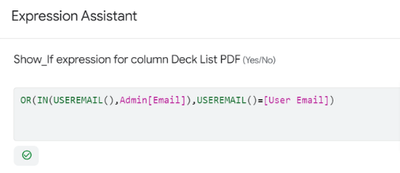

So if I wanted to restrict certain columns only within the table would I add in a Show_If expression?
Yep!
Buy please remember that hiding the column is not secured in any way. It just hides the column, nothing else.
Hey all, this technically solved my issues but raised a few more so I've reset the app back to before the security filter using OR(IN and would like to try and transition to a IF(_THISROW expression.
If I wanted to only show these two rows to users that entered the data and the admin how would that go? IF(_THISROW=[Deck List PDF], ISNOTBLANK....?

This:
OR(
  (USEREMAIL() = [User Email]),
  IN(USEREMAIL(), Admin[Email])
