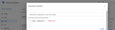

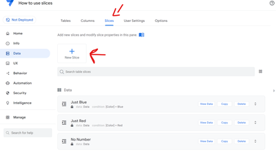

I suppose that you are talking about an APP and not just about a spreadsheet, being the APP based on the spreadsheet that you indicate above. That said, what I understand you need is to show your technologist just a SLICE of the table (i.e. the spreadsheet of your image).
In order to create a slice from your table, you need to create one from here:
then click on "New Slice" and write the condition to use in order to filter your rows in such a way that the column  [Type component] is equal to "Material"

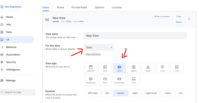

and that's it, you can now create a View where this filtered data are shown. To do so select as Data the Slice you have just created and a Table view if what you want is to show your spreadsheet data as a table.
in my opinion, if my guess is correct, this is all you need. To have a simple and clear example, please consider this APP that you can copy and modify: https://www.appsheet.com/samples/This-app-shows-how-to-slice-your-data?appGuidString=984a5f04-96f6-4...
let me know if this information is helpful or if I am misinterpreting your explanation.

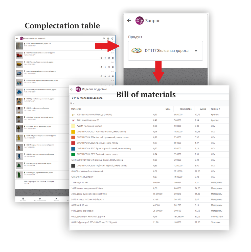

I report on the work done. I haven't been able to implement BOM on the APP side yet. Did it on the tables side. The mechanics are as follows: A request comes from the APP with the necessary SKU, then there is a search of positions in the complectation table, taking into account the type of position, Components go to the next interation, materials to the final selection. At this stage, this implementation suits me, but I think I will return to this issue later. Thanks to all those who helped.bill.png
