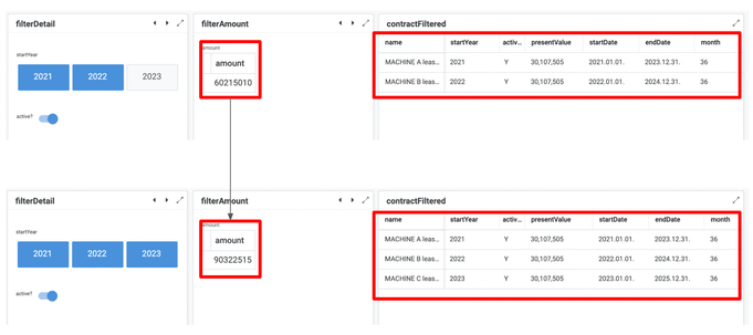

This is my dashboard like your sample"filterDetail" and "filterAmount" are the same row.
When I add "2023" to EnumList on filterDetail view, then contractFiltered view changes immediately, BTW amount changes 20 seconds later NOT immediately (60215010 → 90322515).
Is it normal to take some seconds for changing value that has a "SELELCT" expression?
