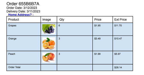

Typically in a PDF report, the size of the image displayed is in proportion to the width of the cell  in the template. So you could have a minimum width for the table column in the template where you are displaying the image. So the image will appear tiny in the report but when you click on it, it will expand properly. In this case, please remove the format rule because you are now controlling the image size with the table cell width in the template.
Example:
Image as it looks in the PDF report
The template's image column width is very less as shown below
The image opens in the browser to a large size, when one clicks on the image in the PDF report as shown below
Example:
Thank you for the example Suvrutt. It seems like I overengineered the thing here. I removed the rule for 1 picture and dit several test. It worked.
I don't remember why the initial issue was. I will try to remove the format rule for all of my pictures and see where it doesn't work like I wanted too.
