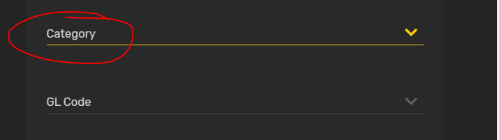

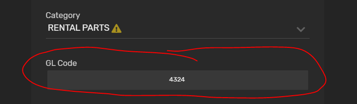

I have a dropwdown menu that shows the value after the user selects the field in the dropdown menu. However, i do not want the user to then have to click the value shown:
Before the user has chosen value from dropdown menu:
After the user has chosen the value from the dropdown menu:
I do not want the user to have to click (4324) from my example above. I wan that value to automatically be chosen

This is how it works at the moment. It does show the correct GL Code, but i was wondering if i can make it already select that GL code, instead of the user having to click on it:

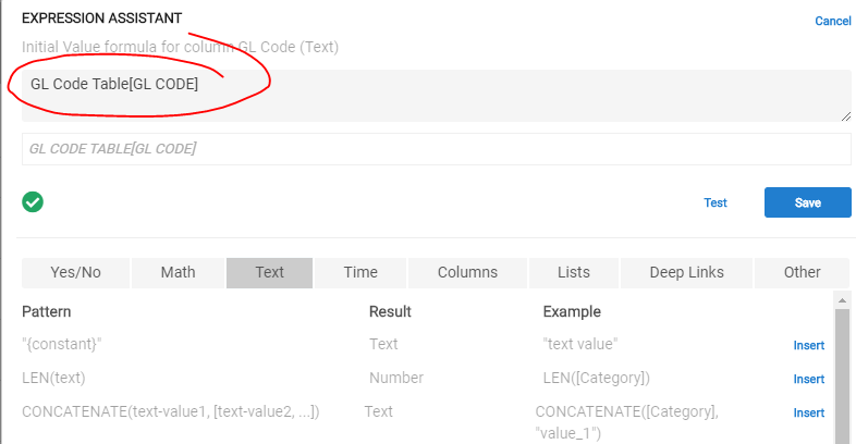

Ok. I see. now i put the formula in the Initial value:
This is the result when i choose any category (seems to just show ALL possible GL Codes):

Not at all. Iโ€™m not surprised by the result you getโ€“we need a better expression.\

The yellow triangle means the Category column is of type Ref, but the columnโ€™s value, RENTAL PARTS, is not a valid Ref-type value. I feel like weโ€™ve gad to deal with problem previouslyโ€ฆ

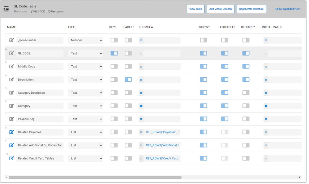

Ok. Here is the Table [Category] - refernces:
โ€œGL Code Tableโ€:
