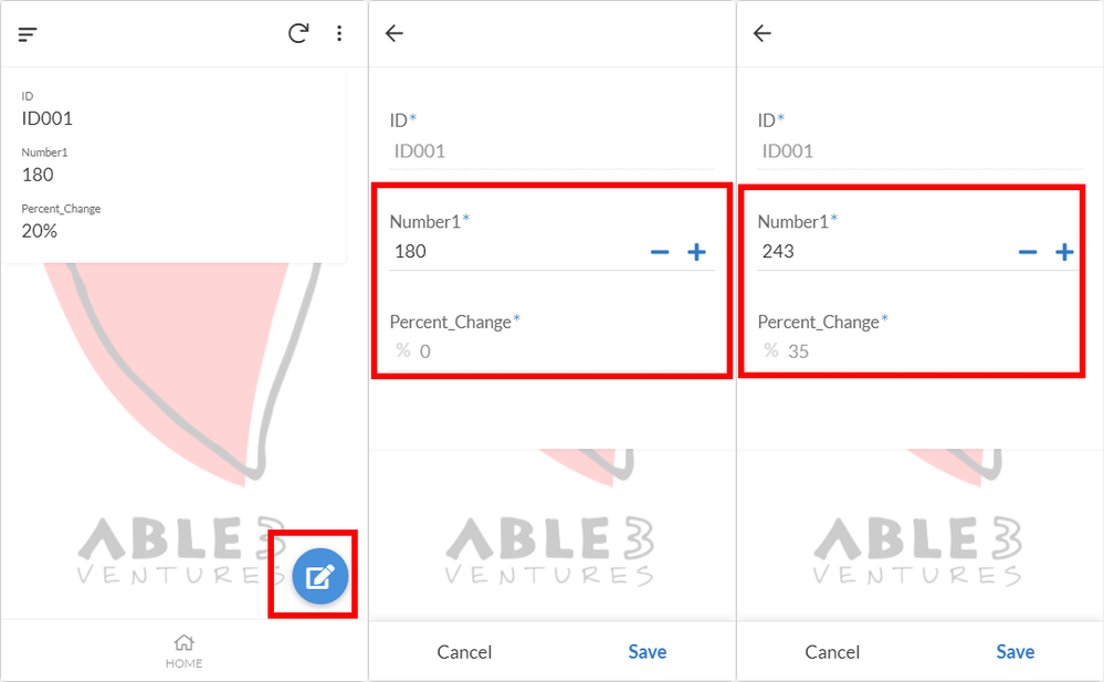

@Tony_Insua
Here is the proof of concept and you can try it from my sample app below with clicking your name on the main menu
APPFORMULA EXPRESSION
IF(
	IN([ID],PercentChange[ID]),
	([Number1] - LOOKUP([_THISROW].[ID],"PercentChange","ID","Number1")) / LOOKUP([_THISROW].[ID],"PercentChange","ID","Number1"),
	NUMBER("")
SAMPLE APP
@Tony_Insua
I have also fixed your TEST APP that you have shared. I have edited the first record where the revenue was $2,200, changed the revenue to $2,500 and [% Change] correctly calculated as 14%. You can see it in you back-end as well.
