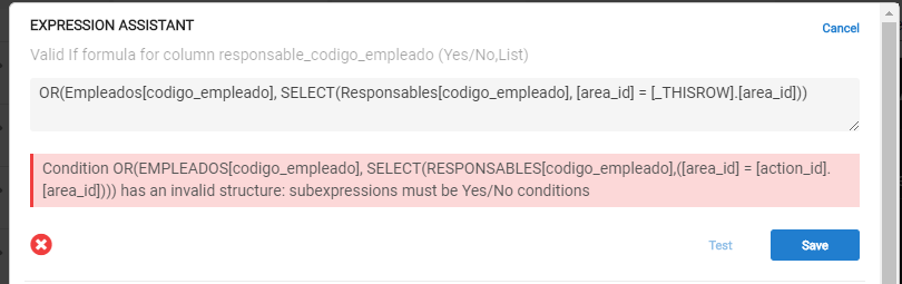

I tried your suggestion and it worked perfectly! But, my apologizes @TyAlevizos , I forgot (I just edited the topicโ€™s title) to say that it is a Dependent Dropdown.
Right now, in my valid_if expression I have a select expression, because data loads depending of another dropdown. I tried added your suggestion using OR() expression but got this error:
You obviously need to restructure the formula.
If you are dropdown is dependent on the value in the other field, you need to take into account when you construct the formula.

Hi @TyAlevizos I tried and get this error:
but I already solved with @tsuji_koichi suggestion. Thank so much both for taking time to help me, really appreciate it.
