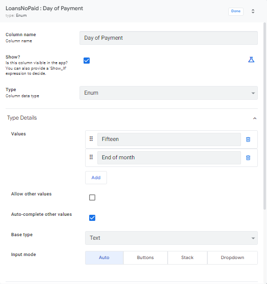

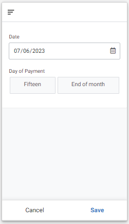

The fields are Date and Enum (see screenshot below).
The following images show details of both fields.
I have the expression TODAY()-1 in the "Initial value" field because I was testing the form, but it can be moved to the "App formula" field when the automation is in place.

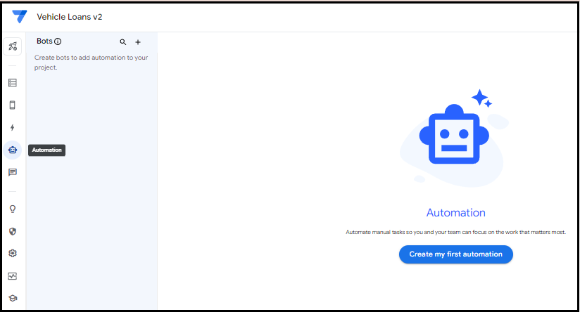

I'm using the new editor, and I can't get the menu you show in your screenshot.  I have no automation yet (my mouse is over the Automation button but the screenshot doesn't show it).
I know it's possible to create the process from the legacy editor, but I wonder how to do it from the new one. Is it possible?
Yes. My screenshots are from the new editor. Hover over the Bots icon, then click on Processes. Go to the top and click on the "+" sign next to Processes to create a new one.
First of all, thank you for the solution you gave me.  I was able to trigger my action on a schedule by creating the process and then calling the process from a bot, just as you mentioned.
I switched to the legacy editor, created the process, I switched back to the new editor, and then I created the bot.
I hover over the Bots icon. My mouse is not visible on the screenshot, but it is there (you can see the icon is highlighted and the word "Automation" is to the right of the icon). The menu (Events, Processes, Tasks) doesn't show up on my end. It appears right after creating the process. I think this behavior is because I don't have any automations yet.
I've tried this with other apps that don't have automations and got the same result.
In order to replicate my issue, you can create a brand new app and try to create a process when there is no automation using the new editor.
Thanks in advance for your time.
That's interesting ๐Ÿ˜€
I tested with an app that has no automation, and yes you are right, the hover menu did not appear with the new editor.
However, I did not switch to the legacy editor, I went on to create a new bot, configured a random event, then added a random step. I now have a process, so I turned linking ON, et voilร , without even saving, the hover menu appeared ๐Ÿ™‚
I guess this is part of the new editor's design focus on reducing clutter, so you don't see Processes in the hover menu until you have one. This is new to me, thank you!
