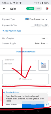

@Suvrutt_Gurjar  sir,
I could see in an app called vyapar ( billing and account app/ software). It indicates the user if the Invoice number already used by another user and askes to enter higher number and in the  second attempt automatically it adds the invoice number + 1 without user initiation. that was pretty cool !! Appsheet has to take  this type of requirements into consideration and bring it into effect.

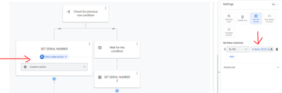

What I have did :
1. I have created a test app  which has one simple table.
2. It has column [ SL NO] , and other some columns like name, date, etc .
       Note : a special column [ KEY] is added and it was set as key column of the table.
3. A bot  was created with name : Set SL NO with wait condition
    Bot configuration :   When this EVENT occurs: When a row is added
            Process :
                     Step 1 . : Check for previous row condition

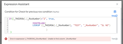

                           Expression logic used :  checks the table has only one record if not checks the previous row column [ SL NO] is not blank.
                                The expression assistant shows the error for the expression  while saving the editor, error did not stop the app  functioning.
Step 2 :  Set SERIAL NUMBER ( this branched step is executed if the  previous row column [SL NO] is not blank).
                                                  Set these column(s)  expression :

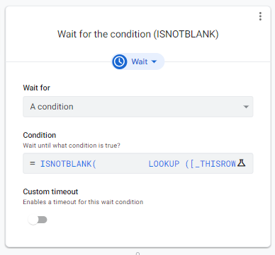

Step 3 : Wait for the condition (ISNOTBLANK).
               Condition is :
      Expression Logic : Checks the previous row column [SL NO] is not blank.

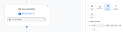

Step 4 (last ) : SET SERIAL NUMBER .
                  same step 2 is repeated.

Step 3 is a wait condition step , until the condition is met other steps are not executed. if the condition  is met it will execute the step 4

step 1 will be executed which checks for condition.  step 2 : SERIAL NUMBER is set since there may be new or  some records in the database.
step 3  is applicable to the 2nd and 3 rd record / row. it  will wait for the condition since 1st record [ SL NO] will be blank.  once the previous row [ SL NO]  ( ie. 1st record [SL NO]) is not blank , step 4 ( SET SERIAL NUMBER) will be executed.  It is a kind of queueing the numbering system.

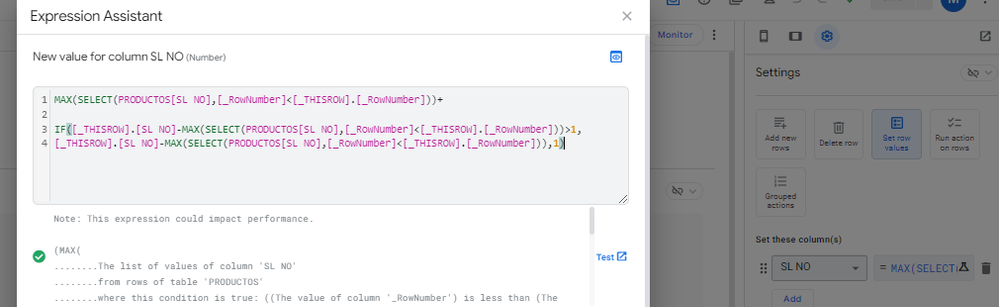

Many trials. But finally i have a solution. No matter how many users or if you delete rows. Serial number not will be affected.
Not bots are required. Just a virtual column with the next formula:
MAX(SELECT(TEST[SL NO],[_RowNumber]<[_THISROW].[_RowNumber]))+
IF([_THISROW].[SL NO]-MAX(SELECT(TEST[SL NO],[_RowNumber]<[_THISROW].[_RowNumber]))>1,
[_THISROW].[SL NO]-MAX(SELECT(TEST[SL NO],[_RowNumber]<[_THISROW].[_RowNumber])),1)
Line 1: Select the max value of existing records without taking into account new records.
Line 3: Look if some records were deleted. If so, add them
Line 4: If there are no deleted rows, just add 1 to the consecutive
Name of virtual column is [SL NO]? Some thing other  than [ SL NO ]
When I use virtual column, still was appunting to [SL NO] column who could have the same original problem (duplicate).
So, if for any reason you have a duplicate [SL NO] you can identify and solve it through the virtual column (Line 5):
[Virtual SL NO]
MAX(SELECT(PRODUCTOS[SL NO],[_RowNumber]<[_THISROW].[_RowNumber]))+
IF([_THISROW].[SL NO]-MAX(SELECT(PRODUCTOS[SL NO],[_RowNumber]<[_THISROW].[_RowNumber]))>1,[_THISROW].[SL NO]-MAX(SELECT(PRODUCTOS[SL NO],[_RowNumber]<[_THISROW].[_RowNumber])),1)+
COUNT(SELECT(PRODUCTOS[SL NO],AND([_RowNumber]<[_THISROW].[_RowNumber],[SL NO]=[_THISROW].[SL NO])))
You can named virtual column any you prefer. [Virtual SL NO]
And the way to get values for [SL NO] column Still is by a Bot: Set new values and use the given formula .
This formula in the bot must to be enough to get unique SL NO. I tried several times and not get duplicate values. But if ocurrs the [Virtual SL NO] will solve it.

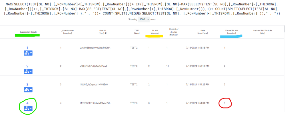

I had improve the formula FOR [Virtual SL NO] (Line 5: Count all duplicate values and add it to [Vitrual SL NO])
IF([_THISROW].[SL NO]-MAX(SELECT(TEST[SL NO],[_RowNumber]<[_THISROW].[_RowNumber]))>1,[_THISROW].[SL NO]-MAX(SELECT(TEST[SL NO],[_RowNumber]<[_THISROW].[_RowNumber])),1)+
COUNT(SPLIT(SELECT(TEST[SL NO],
[_RowNumber]<[_THISROW].[_RowNumber] )," , "))-
COUNT(SPLIT(UNIQUE(SELECT(TEST[SL NO],
[_RowNumber]<[_THISROW].[_RowNumber] ))," , "))
The function it works but i don't know why virtual column is not calculating, even if i edit the row or made any change in the table (add, delete).
Please help with this. Here a screenshot for the test of virtual column, as you can see, the "Expression result" is ok but the value given for [Virtual SL NO] is wrong.
  • [SL NO]: (Yellow) Normal column written by the bot.
  • [Virtual SL NO]: (Blue) Result of virtual column when record was created, but is not re-calculate to the correct Expression Result
