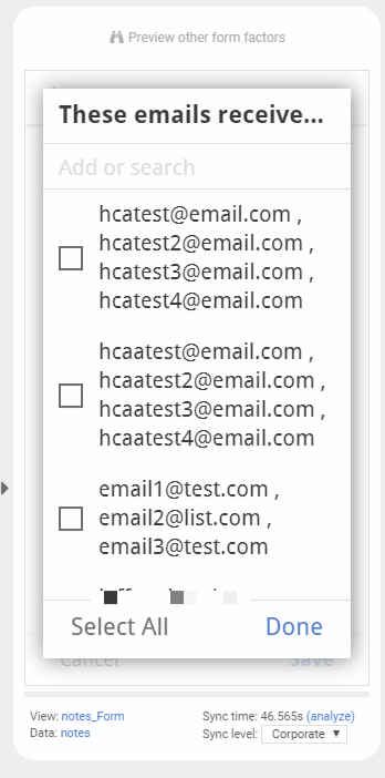

I’ve got the following formula, but it’s not parsing things as I need:
split([notification_patient_facility].[notification_emails] + HCAs[HCA_Notification_Email_Options] + Hospitals[Hospital_Notification_Email_Options], “,”) - list("")
this gives me the following:
The first element of the list ([notification_patient_facility].[notification_emails]) is split into options, but the imported table options (HCAs[HCA_Notification_Email_Options] + Hospitals[Hospital_Notification_Email_Options]) are imported as a “list-option.”
I tried not including the SPLIT(), but then it was just a list of lists. I’ve also tried different split denominators: " , " (space, comma, space) and ", " (comma, space) - but all result in the same thing with the two table imports being list-options.
I also tried wrapping the whole thing in ANOTHER split, but it resulted in the same thing again (curiously).

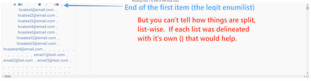

I moved the formula from the valid if to the suggested values, so others could be added, and you see the list of list much better:
How about a new VC with that value? I’m interested to see if there’s something in the merged list and lists of lists that would interfere with SPLIT().
Unfortunately this is a live app, with active users and a TON of data, so something like that is out of the question.
I was thinking it might be something about the delimiter I use in the SPLIT, that’s why I was trying different things. To date I’ve tried:
But each results in the same thing, seems the system ignores the spaces and just uses the comma.
Wouldn’t surprise me if the list-of-lists is introducing a problem. Is that a construct you’ve used successfully in the past?
It’s always been a problem. I’ve never been able to successfully solve it, usually I find another way to bring about the behavior I’m looking to create.
You could create but not save (or delete before save) the VC just to get into Expression Assistant.
The problem here is that you can’t tell how things are split in the previous page; the rendering element that makes what we see in the testing page doesn’t split things differently - each item is separated individually.
But when you open the app with the things saved, that’s when you see the items of the lists for what they really are:
If you compare the two pictures, you can see where things are split in the testing page - but there’s no way to actually tell by that unless you can see it elsewhere.
