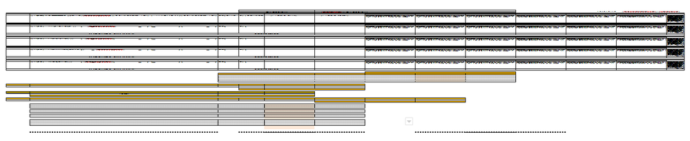

Hello friends, this isn’t exactly an appsheet question, but i hope one of our workflow veterans can give me a hand here, i have a template with potentially many rows, and i need those rows to fit the height of the contents of the cells ir order to waste as little paper as possible when printing them.
When i fill in the cells directly on the google docs template it looks like this:
Image 1
When Appsheet generates the pdf and mails it, it looks like this:
Image 2
That’s a lot of space between rows, and it really adds up when there are more rows involved.
These are the settings for the table:
Settings

Hey Matt ! thank you again for your very detailed answer, i have tried the steps you mentioned but i’m not seeing a lot of change on my document, I actually saw so little change i tried to set the custom spacing to 0.06 (the absolute minimum) just to see what appsheet would print, this is the comparison:
Document as seen in the template
Completely flattened
Document generated by appsheet
Almost normal, but still too spaced lol
I wonder if i could mail appsheet support about this, since it is in a relatively grey area, because the issue is not strictly within Appsheet, but its related to how Appsheet processes the workflow template. 3X_c_5_c57b07b36f7d1590eca8b64a6905a1cfe74a4acd.gif

Update: I have officially given up, appsheet support is my last hope.
I have tried EVERYTHING (i think), i made a new template for testing, in which i formatted every single cell individually using @MultiTech_Visions tips, and i found out something:
The issue doesn’t exist for rows with multiple lines of text
As you can see, the spacing in that third row with the generic text is juuust fine, so i believe it is Appsheet who is forcing a minimum row height for rows that contain start expressions, i have reported my findings to the appsheet support, and i am awaiting further responses.
EDIT: Forgot the parrot 3X_d_5_d51363a862e7ab883241c312ac5d7f271579cdd3.gif
FINAL UPDATE AND ENDING: I LOVE YOU MICHELE FROM APPSHEET SUPPORT 3X_9_1_91a384c900eb963b0c73fcaa14cdef5ae95ba01f.gif
The workaround is the following: click on the page, press CTRL+A (or from Edit -> Select all), then right click and select "Update 'normal text' to match"
Gonna leave this here in case someone needs it eventually 3X_d_5_d51363a862e7ab883241c312ac5d7f271579cdd3.gif
