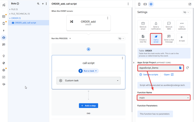

The screenshot provided looks at the trigger on Apps Script side.
Your question was on AppSheet side, right?
Did you call your script this way, for example?
For reference: Call Apps Script from an automation - AppSheet Help

It might be an issue with my Apps Script code, or possibly with the triggers I set up in Apps Script. I've attached the screenshot below for reference :
