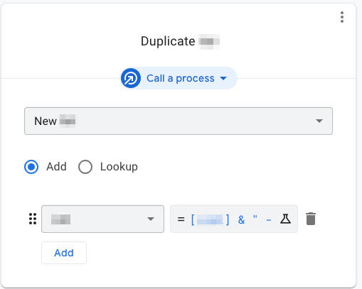

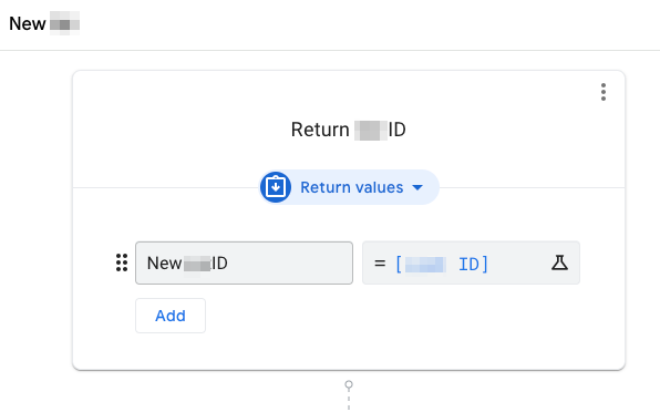

The "Duplicate item" Call a process step calls the "New item" process, whose Return a value step returns a value for NewItemID. I can then reliably reference the NewItemID value in, for example, a straightforward data action step to set a column to that value. This all works reliably as explained in Use values from a previous step in a non-reusable action or task and Use 'Call a process' and 'Return values' steps in ... - Google Cloud Community
Call a process step: Duplicate item
Return a value step: Return item ID
