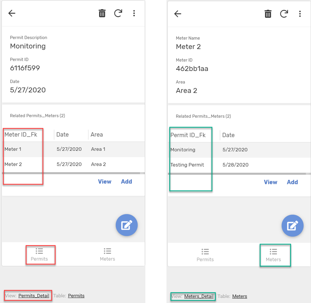

It seems Iโ€™m having a little trouble following your steps. In step 1 do you need a filter condition that points to [_THISROW] from either of the two tables? I tried doing ref-rows to one of my slices, but when Iโ€™m in my detail view, the column(ref to slice) does not show anything. Am I doing something wrong here?
No need to create filter condition for this view arrangement.
I just create a sample based on your description above, to make sure my understanding, is below picture represent what you want?
I ended up making it work. Thank you for the instructions.
