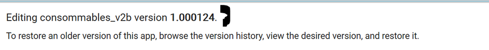

At opening the app, the device does not load the latest version.
Is it normal ? Should I do a specific action for updating all versions ?
I figured out lately that I can click on the button
But I’m not sure of what happens at clicking here : will they ALL see the message, will they ALL have the newest version…?
Here is the user version: (1.000097)
Here is the current actual version: (1.000124)
Obviously, this particular device met an issue at updating versions for a long time.
In addition, other users did not have trouble like this one.
Many thanks for your help

Regarding the app versioning (Latest, Stable, Default), this is a AppSheet Business Plan feature. It does not have an affect with the accounts other than Business Plan enrolled.
Regarding the error message, it seems that you have added a column to your Mouvements table where the actual number of columns in the back-end (19) is not matching with the number of columns in the table schema of the app (18). Users generally experience this error when you update an app build because the users have the tendency of soft closing the app which lets the app running in the mobile devices background. When the fetch the app back from memory, the app will have an older version as the app is not synced, haven’t fetched the latest app build from the server and they will face this error when adding/deleting/updating app data.
In general, pressing Cancel in this screen returns you back to the app’s initial view and you need to:
[1] Open the hamgurger menu
[2] Reset the changes
[3] Sync the app before going any further
