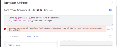

hi, I have to manage the amount of liquid in a container. Our measurement systems are not very precise and it often happens that measurements are not correct to the nearest cent.
To give an example: an instrument indicates that 3 liters of "product" have been poured towards "A". System "A" declares that it has received 2.6, etc...
When the container is empty, is not possible to accept a negative value from the starting container because it must be considered empty. Waiting to receive more precise measuring devices, I need to solve this thing.
As you know I am not an expert with expressions and in fact I am making mistakes.
Please tell me where I'm going wrong.
Thanks for your attention

If I understand you want the formula to calculate [LITRI CONTENUTI] where this is the current column.
[LITRI CONTENUTI] = [LITRI 1] - [LITRE 2] + [ LITRI RICARICATTI IN CISTERNA]
This is the total sum which should never go negative. The IF() statement works as below
IF() = IF(TRUE, THEN,ELSE)
IF( [LITRI CONTENUTI] < 1, THEN [LITRI CONTENUTI] =0, ELSE =[LITRI CONTENUTI])
So you need
IF( ([LITRI 1] - [LITRE 2] + [ LITRI RICARICATTI IN CISTERNA] < 1) , 0, [LITRI 1] -[LITRE 2] + [ LITRI RICARICATTI IN CISTERNA])
So if the sum is less than 1 it sets [LITRI CONTENUTI] to zero otherwise it accepts the sum.
Hope this is what you require!

thank you very much
