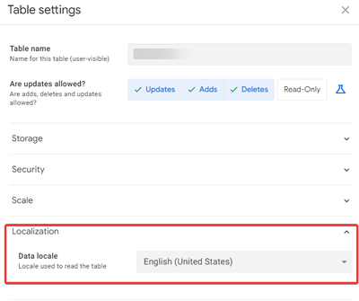

Additionnaly, check that the Google Sheets locale is the same than your table locale in your app ๐Ÿ™‚

The column set as date, both Google sheet and appsheet set to the same locale definition. any way, I think it should not produce point intead of slash in any locale definition. that's weird and it started only in the last days with no change made, before that it worked with no issue.

What locales are you using? I checked one of my old apps that is using gSheet, and it has recorded dates with dots from 2017 with Finnish locale settings.
I'm using Israel locale settings. it works fine for years and I didn't change anything. But now I tried changing it to UK, and it worked. The date appeared as dd/mm/yyyy. So, I suppose the locale settings for Israel have recently changed in AppSheet.
