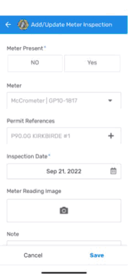

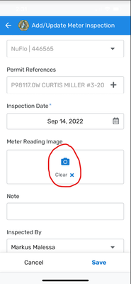

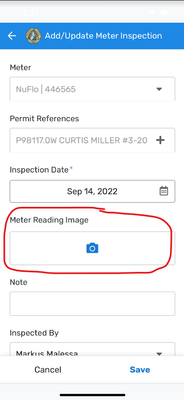

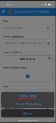

Running iPhone 13 on iOS 16 and discovered that an image column when taking a new photo does not show a preview of the picture itself in the form. Furthermore, when saving the new row with the image column, the image does not actually save and returns a 404 error where the image would typically display in the detail view.
Markus_Malessa_0-1663188092031.pngMarkus_Malessa_1-1663188135363.pngMarkus_Malessa_2-1663188182831.pngMarkus_Malessa_3-1663188241396.png
In the last screenshot, typically where the camera icon is, the image would be displayed. If I choose an image from my existing images, then a preview of the image does display.

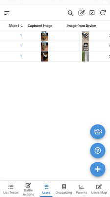

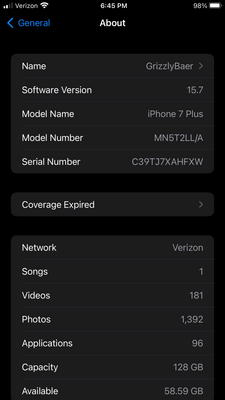

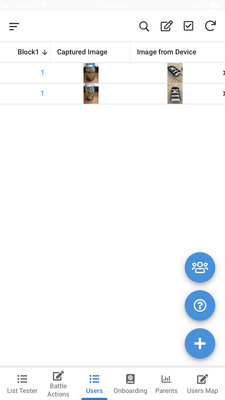

I am not seeing any difference in behavior.  I am using an iPhone 7 that was running iOS 15.6.1 before first test, upgraded to 15.7 and then retested.
To test, I simply defined two columns as "Image" and made no other changes.  I allowed AppSheet default image behavior deal with saving and retrieving images.  Below are the results.

iOS before Tests
Saved images after first test, from camera and from image list
Update to iOS 15.7

3rd row showing state of saved images after update

This has actually gotten worse for me now! I click the camera icon to bring up the camera functionality, select 'Take a Photo', snap a picture, select 'Use Photo'. Then the app just restarts, but skips over the syncing step and then goes back to the form I tried taking a picture in.

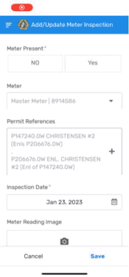

Looks like this issue has returned. Tested today on IPhone 13, iOS 16.1.1, AppSheet version 15.2. Attached a Gif. Going to upgrade the phone to iOS 16.3 to see if that takes care of the issue.
See my post for a workaround I found to fix this for the time being. Hopefully it helps you as well
https://www.googlecloudcommunity.com/gc/AppSheet-Q-A/Error-taking-photos-directly-in-app-after-updat...
Thanks for that solution. After updating to iOS 16.3 it appears this is resolved again. Albeit I could not say if it’s due to the iOS update or if the phone restart cleared the data cache maybe.
