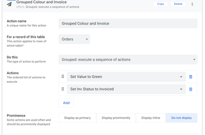

Thank you. You could use grouped actions in the bot. Testing showed grouped action executes.
In the example below "Orders" is the parent table and "Order Details" is the child table.
The grouped action
Set value to Green on parent table
Reference action on parent to select child table rows for setting invoice status:
Referenced action on child to set invoice status:
Grouped action included in bot:

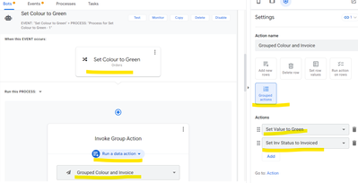

Thank you for the details. Assuming you wish to change the status of children records of the same parent record where the first bot changes the parent record's [Colour] column to "Green", you could try the Grouped action option in the bot.
You could create the data change action "Change Colour to Green" and reference action to change the related children of "Xero" table to "Invoiced" status. Then you could group these two actions and use in the bot as grouped action option. My testing showed that grouped action option executes both the actions.
Grouped action in actions pane:

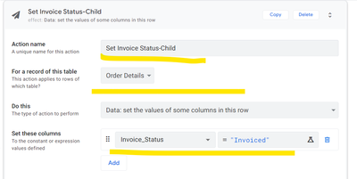

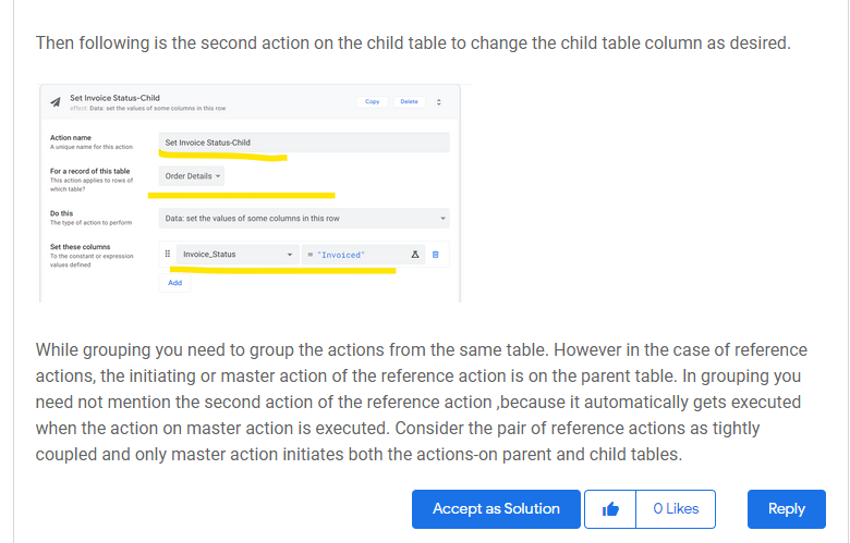

I have detailed the reference action in the screenshots above. Reference actions always act in pairs. The first action created on parent table lists the key of the rows of the child table that need to change. In the example, the following is the first reference action on parent. As you can see, it lists the records of the child table to act on and also mentions what action to execute in the child table. It also mentions the parent table and referenced table or the child table
Then following is the second action on the child table to change the child table column as desired.
While grouping you need to group the actions from the same table. However in the case of reference actions, the initiating or master action of the reference action is on the parent table. In grouping you need not mention the second action of the reference action ,because it automatically gets executed when the action on master action is executed. Consider the pair of reference actions as tightly coupled and only master action initiates both the actions-on parent and child tables.

I have noticed the group action ihn Job Board is not being called by the Bot so I tried that and an error came up that two group actions can't be called in one event.  Makes sense.
What can I try next?  I am stuck.
Are both actions included in the group action? Colour and Master reference action?
And is the group action being called in the bot as sample screenshots l shared?
Actually,  the bot configuration is relatively simple and I shared the screenshots after testing at my end that it works. Request you to carefully again verify if you are not missing some configuration or setting.

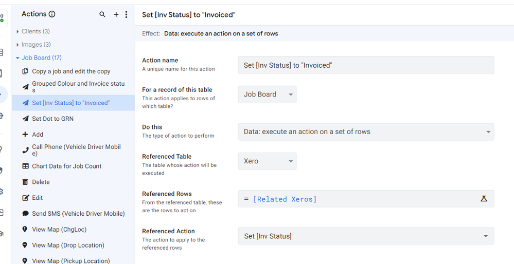

The test of the referenced rows [Related Xeros] is returning the Xero[Inv ID] list values as expected, but the Set [Inv Status] action is not being applied?
Could you share relevant screenshots of the actions and bot?
Here they are
What kind of action "Set [Invoice Status] to Invoiced "is?
Data: set the value of some of the columns in this row.
It needs to be " execute an action on a set of rows" type. That is master action of reference actions pair.
Set [Inv Status] was my version of your earlier post...
This is the child action?
Oh okay , it needs to be the following action ( master action) included in the group action.
Sorry Suvrutt, my mistake,
This is my master ref.
Oh okay, then it sounds good to go. Could you update what error and where are you getting it?

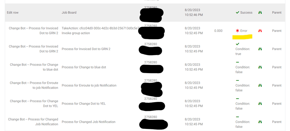

Below is the audit log showing the error.  Not that helpful to me at least. Again the [Colour] is changing, not the [Inv Status] flag.
This is the error message...
"Errors": "Error: 'Execute a Sequence of Actions' Grouped action 'Grouped Colour and Invoice status' child action 'Set [Inv Status] to \"Invoiced\"' failed due to error: Error: Perform DataAction 'Set [Inv Status]' failed because Row having key '284514da' in table 'Xero' in field 'Reference' is required to have a value \nError: Perform DataAction 'Set [Inv Status]' failed because Row having key '5dfb9c16' in table 'Xero' in field 'Reference' is required to have a value",
Suvrutt,
The problem was that a required column was no populated in the Xero table and so it threw out an error.  I changed deselected the required box in the column and your solution work well!
