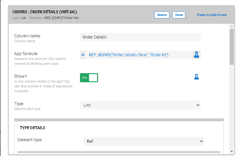

Rev ref column settings in parent "Order Table"

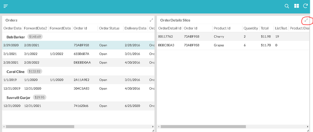

Interactive dashboard on "Orders ( Open Orders) and Order Details Slice
Here the order ID for all child records is same as that selected in parent table.

Interactive Dashboard view. On the left Orders view. It is parent table slice with with open orders. On the right, order details slice view. On the right, only shortlisted child records are there for the selected parent record. Please pay attention to the right hand top corner encircled in red to expand the child slice view.

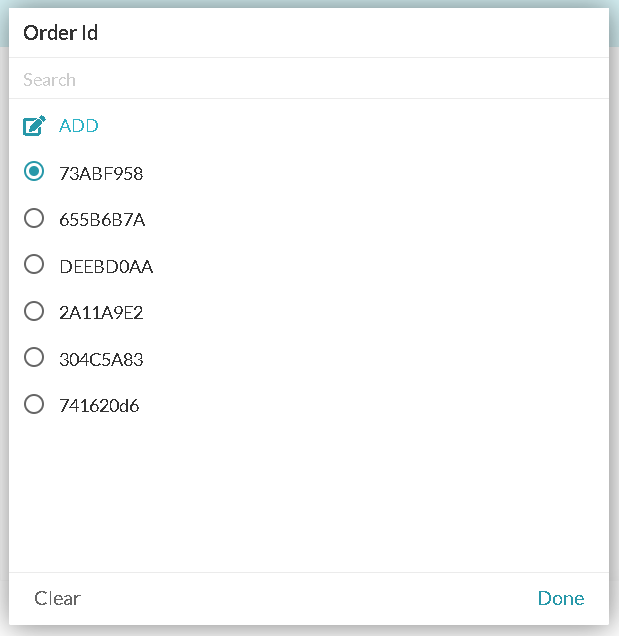

Click on Add sign. New child table form appears. Please pay attention to encircled Order ID reference column.
Please expand the Order ID column. All tghose order IDs in the drop down are for “Open Orders” only ( Equivalent to “Active” projects in your case)
Basically, while going to parent table from the child table , you will necessarily need to select an existing parent record. The above mentioned addition in logic ensures that when you navigate to select parent record from the child record slice, it restricts the user to only parent record IDs with "Active " status.
