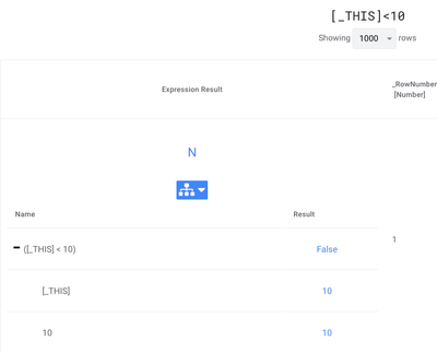

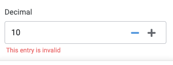

In a brief test, it looks like it works for me in a Decimal column--at least, in the expression editor's Test function and in the app editor's emulator.
Maybe post a screenshot of your column configuration and the app behavior you observe. Someone might notice a misconfigured detail.
