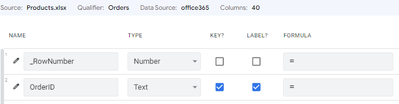

I changed as suggested, think I was also going wrong with the column name as mine is called " _RowNumber". Also tried using the table key value but received the same.
It is linking to the app but its linking to a blank screen, where it is saying no items.
When the link initially loads I can see the https and then the row number but it changes after a few seconds
There's a piece of code missing right after the name of the view. It must be #view=Orders_Detail&row=" & ENCODEURL([OrderID]), "CLICK HERE")

Found it.
You are not opening the quotes at the beginning of HYPERLINK expression.
Try HYPERLINK("https: .....
It is working perfectly thank you so much! 🙂
