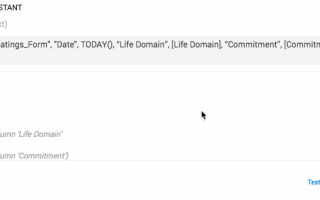

It sounds like you’re using LINKTOFORM() to insert values into the form, and you’re choosing the label instead of the key.
Post a picture of your LINKTOFORM() expression and the table/column settings for the column(s) involved.

Here is the LINKTOFORM expression:
And here are the table/column settings for the columns involved:
Let me know if these are not the screens you’re looking for
I can’t tell for sure, but it looks like you just need to add .[Key] to both column references in the LINKTOFORM().
Try:
LINKTOFORM(“Ratings_Form”,
“Date”,TODAY(),
“Life Domain”, [Life Domain].[Domain ID], <<-Not sure if that’s the right key field name
“Commitment”, [Commitment].[Plan ID])
