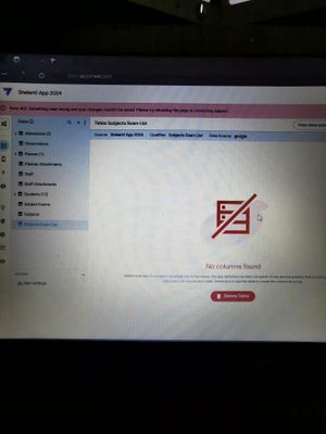

Loading Tables Error
@lizlynch @MultiTech Does anyone get this error when adding tables from sheets, it started about an hour ago...

@MultiTech I checked my own app and it worked, the one I got error on was as  co-author with permissions to the sheet. Been adding tables from it the last few days and today the permission has blocked it seems.
Are you able add a table as a co-author on your side, if you have one to test with. Unless I have lost my mind and been somehow doing this and it's always not been allowed.

@lizlynch  Thank you, I contacted support and was told I cannot do this. I built as a co-author for a client using my core account to build as co-author for my client on a free account whereby they shared access to their sheet for me, I have added multiple tables over last few weeks by clicking the suggested table to add after creating them on the shared client sheet and since yesterday it suddenly blocked. I contacted support and was told to check this document shown below. No one can explain how I built my clients app up until now using this method... Apparently It can't be done if not a team shared data source which is compatible with Enterprise plan of workspace.
