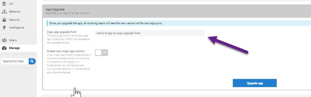

Here is the article that describes the App Upgrade feature. Note that it is only available in PRO (and Business) pricing plans.

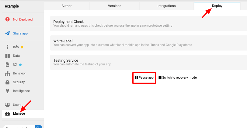

Does โ€œPause appโ€ stop deployments from happening? So I could make a number of changes and test them and then un-pause for all changes to go at once?
As I recall, pause prevents syncs and gives the user a message of some sort. I donโ€™t recall whether it actually deactivates (โ€œpausesโ€) apps that connect while itโ€™s in effect. Itโ€™s easy enough to test.
Thank you Steve
I tested it out and discovered that all users including myself will get the error page
This prevents me to use the emulator to test out my updates. I understand that I need to get the Business Plan to get versioning control but I just need users to be redirected to this maintenance page while I finish updating the app.

Regarding the case where the app is paused but I am a user that has already the app opened, it seems that I was still able to sync data partially by navigating to different pages and launching the sync. I had 17 syncs to process, I manually launched the sync and 3 syncs got processed then received the error message. Went on another page and relaunched the sync and another small number of syncs got processed. At one point the maintenance page error disappears and I had this error message: โ€œa duplicate request is already in progress. Please wait a moment and try again.โ€.

Looks like I need to do a copy of the app, do my changes then use this feature.
