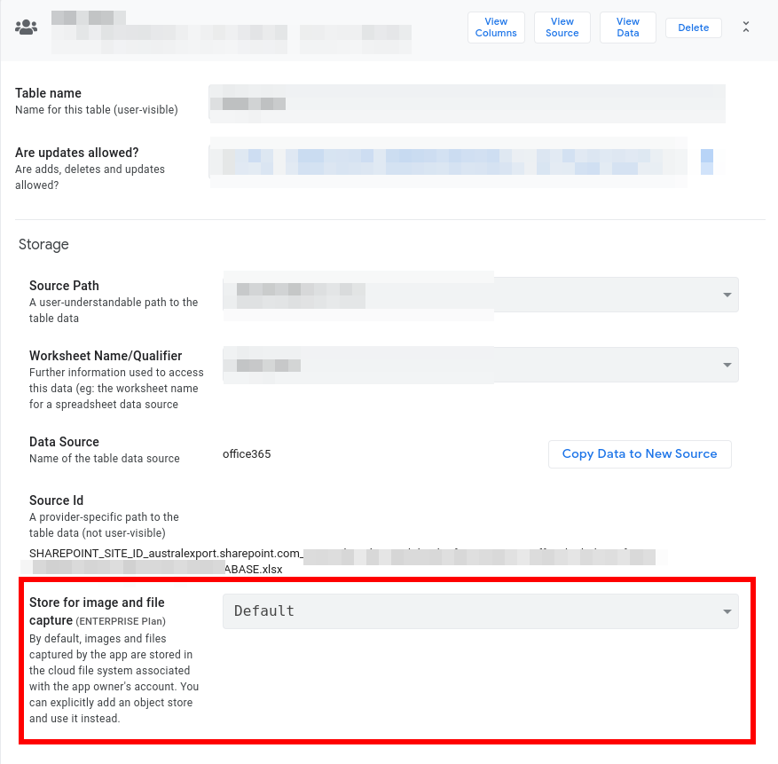

Also, check your SQL table on appsheet, and see which config is under this:
Hi @SkrOYC, so I tried the above but still no luck.

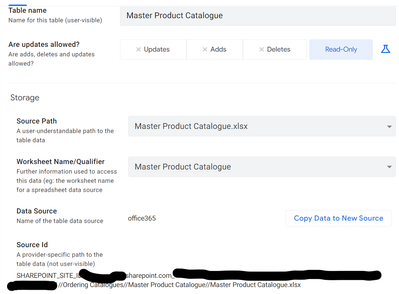

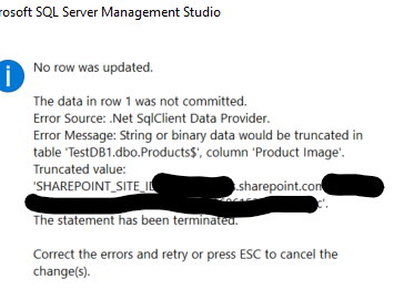

When data is in Sharepoint, Source Id is
so I took the above ... Master Product Catalogue/Product Images/ .....jpg and added it to 1st product in table database and got the below error
Also, I think the below is correct as this is where other images (unrelated to products) that are captured through the app are stored.

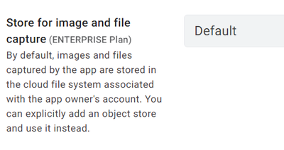

@Martina_Hawkins wrote:
Do you see any options there aside from Default?
Also, if you try to match the App Default Folder with the one where the images are, does that display the images as if the default folder were the one with the excel on a "normal" scenario (not sql)?
I'm jus trying to help though, I don't have experience on this.

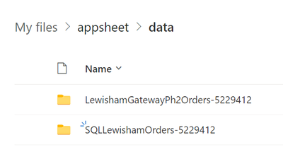

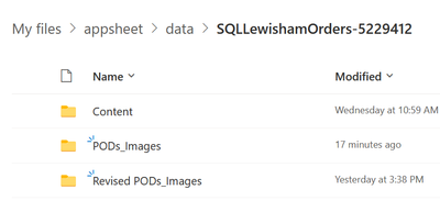

Below is not about the Product images but about the images users upload throught the app for other processes which is not working - images not getting stored.
In my App where the data is coming from Sharepoint (location in screenshot above) the default folder is
/appsheet/data/LewishamGatewayPh2Orders-5229412
All that is stored here are my templates in a folder called Contents
Images that users upload through the app are stored in folders of format  tablename_Images in the same location as the spreadsheet, not the default folder.
Now that I have no spreadsheet so no path for spreadsheet,  where does tablename_images get created?

I didn't change anything but this is sort of working but something strange going on.
I have 2 tables PODs and Revised POD's.
I uploaded an image to POD and it is showing in the App but not in the Appdata.... folder
I uploaded 2 photos to Revised POD, both showing in the App but only one in appdata...

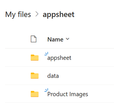

@Marc_Dillon , I'm getting somewhere now with your suggestion of
  • Maybe all apps should have their "default app folder" set to the same high-level folder, like "appsheet".
  • Then for all image/file columns, appropriately set the folder path setting so that files are saved in an organized fashion.
So I created Product Images folder under Appsheet and moved some images in here and they can now be seen in multiple apps. The Default folder in properties is set at /appsheet

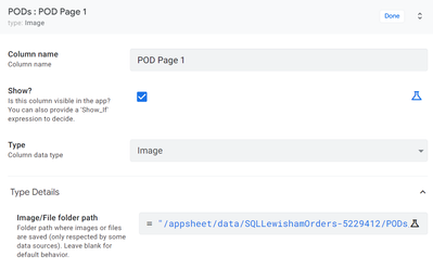

I then created folders to hold the images that will be taken using the app
I changed the Image/File folder path in the image column of the table to point to created folder

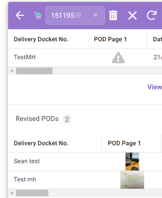

I uploaded an image
- it appeared in the app
- it appeared in the database as
- it did not appear in saved folder and then it disappeared from app - yellow triangle
I uploaded another image to another record
- it appeared in app and is still there
- it did not appear in folder
- it is in database like this
don't know what is going on here

So I tested again, no changes made to App.
Image appeared in app
Saved to OneDrive
Shows Onedrive path in database
Then !!! image disappeared from app
Synced the app and it appeared again
All very sporadic.  Couldn't put this into production

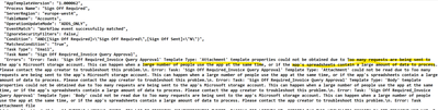

Have run into another problem.  The reason for testing out moving to a database was because we were getting the error message - Too many resquests... I thought and was led to believe that this was because Excel spreadsheet could not cope with the amount of data.
Still getting the error message.  There are no spreadsheets and there is one user!

That error message talks about accessing a template file. That would still be on your Sharepoint even after you moved all data to SQL. Also, I believe the images are stored in 64bit as a backup when the cloud storage is not accessible when the record was saved. There's obviously still an issue with the connection between Appsheet and Sharepoint. Have you contacted Sharepoint support at all? Perhaps they can shed some light on why you're running into these (rate-limiting ?) issues?
