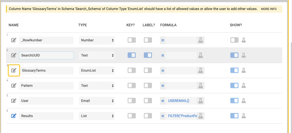

I did think that would be an issue, it not being a list, but I wasn’t sure how the ‘multi-select’ function passes back the selected values. I did try what you suggested but it generates the same error, mentioned earlier. See screen-shot below.
In the Search table, which is where I am trying to capture the selected values, [GlossaryTerms] is defined to be EnumList. I have also tried defining it as Enum and Text, both generate the same error on triggering the action.
The Results of using the selected values is given by the formula:
FILTER(“ProductFeature”,
OR( ISBLANK([_THISROW].[GlossaryTerms]) , IN([GlossaryUUID], [_THISROW].[GlossaryTerms]) )
Make sure the EnumList column allows other values:
Does the column have a Valid If expression?
Hi Steve,
That worked. I was trying to sort the list of glossary terms in the ‘valid if formula’, which was causing the error message. Replaced this with OrderBy and it now works. All this does is store the selected terms in a search table.
