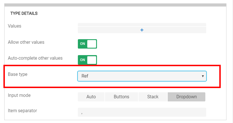

With your Enumlist Columnโ€™s structure:
However thereโ€™s a small editor glitch here: after you select the REF as type, you shall see the target table dropdown but it doesnโ€™t appear. Just save it, save the editor and then open the column structure again and you will see the target table dropdown to select as a REF table.

@LeventK Sure. When choosing โ€œRefโ€ for a column type, and โ€œdropdownโ€ as input method, the system automatically creates a virtual column in the referenced table, and adds an expression like โ€œREF_ROWS(โ€œcrm_projectsโ€, โ€œownerโ€)โ€ to the formula field
However, if you choose " Enum List" as column type, and โ€œRefโ€ as base type, (as per your instructions), the virtual column isnโ€™t created any more, therefore the automatic ref view is also absent.
Could this be a bug? My logic says it should create the virtual columns as well, considering the โ€œRefโ€ base type.
@Cristian_Maria
Itโ€™s not a bugโ€ฆThe reference and de-referencing does not work like that. In fact the logic is simple:
