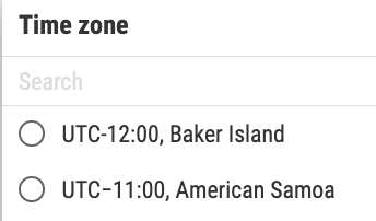

This works quite well in button enums of the kind that @Fabian demonstrated. Unfortunately, however, I encountered a problem with dropdown enums. First, here’s what I want:

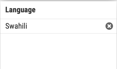

Unfortunately, however, when I try to use the “suggested values” spot to control what is displayed (so that I can have different enums in the same column) the “Search” area becomes “Add or search”:
As my app is not designed to allow people to invent their own time zones, I don’t want this. By the way, this happens even though “Allow other values” is off.
I think this is a bug and I think it means that it’s probably better to use a single column for one enum in just one row. Here are my questions: Am I right about this? Is is better to use multiple columns even though it seems sort of inefficient? Also, is there a way around the problem I encountered?

The idea of changing the localization setting had not occurred to me. It changed the appearance but not the function:
The plus (+) should not appear:
I think I’ll report this as a bug. I doubt that it’s an important bug for most creators but it would still be nice for the platform to respond predictably. In other words, since the “allow other values” is off, it shouldn’t allow them.
