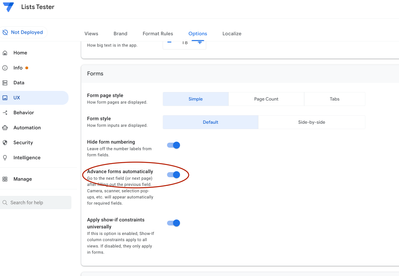

  1. turn on Auto-Advance feature for Forms (see image below)
  2. make the NFC column required
  3. set the NFC column as the first field on the form,
...when you open the form it will automatically open the NFC scanner window ready to scan.
There is also an ability Auto-Save and Auto-Reopen the Form on the Form view definition.  Then you can Scan - Scan - Scan, etc without ever needing to touch the device ... until you are done.
Turn on "Advance Forms Automatically" feature
