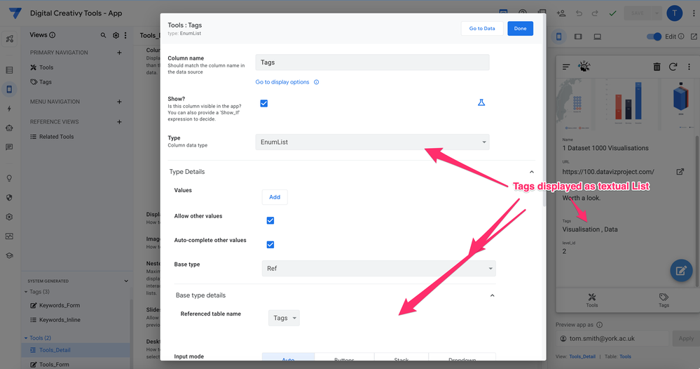

Tools have a Name and URL and a Tags EnumList  that works fine. See me editing a Tool's tags here. I can select multiple tags for each Tool.

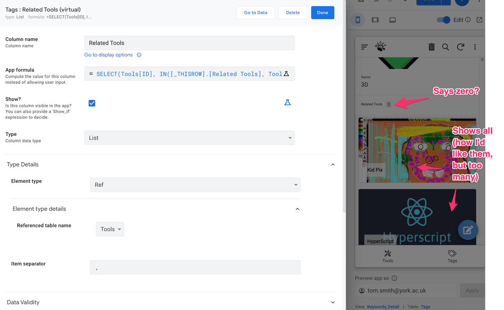

Going the other way, I created a virtual field for Related Tools. Where, when viewing a Tag, you can see which Tools belong to that Tag. You can see below, Related Tools is an EnumList, with a Base ref of Ref of which is Tool and an expression of...
SELECT(Tools[ID], IN([_THISROW].[ID], Tools[Tags]) )
...and it almost works, but returns a list of the Tool's name (which is cool) but I'd prefer a listing I could view like cards, each one it's own thing... if you get what I mean.

Create a Card view for Tools and select the type as Ref.  It should then show it.
If I do that I get this...

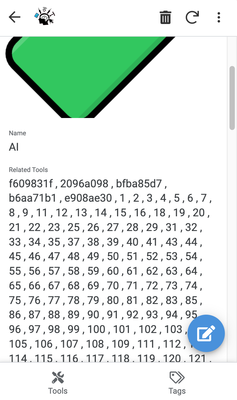

When I changed the Related Tools to Ref, it broke, but if I change it to List it works, but only pulls back the Tool IDs.... but ideally I'd like them displayed like a Deck
My Related formula isn't working too, as it's bring back ALL the Tools IDs (each tool only has two or three tags).

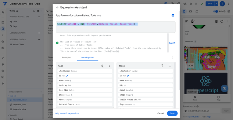

Almost there... I'm not sure if changing it Card View made a difference or not, but I think I've clarified that a. My approach of
SELECT(Tools[ID], IN([_THISROW].[Related Tools], Tools[Tags]) )
is bringing back ALL the Tools (presumably because the TOOL's ID is in the column of Tool's Tags... whereas I want it to return the Tools rows where the Tool's ID is in that Tool's row's Tags.

My Virtual column is like this (which so nearly works)

I simply want to nicely list the Tags each Tool has (it's just a column in Tools with a list of IDs) ... At the moment it displays the right data but textually...
But what I want to display is something closer to the edit form for Tags, like this...
Thing is, this is a different problem, in that it's definitely getting the correct data, and can display it how I want to... but I'm coming at the data from the other end. I want to make it a List item then define the base type but it won't let me do that. A textual link would be fine, but the edit form is better.
