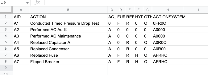

The ACTIONS table has columns for multiple systems (AC, Furnace, Refrigeration) and each of those columns contains either a 0 if it doesn't apply to that system or an appropriate letter (A for AC, F for Furnace, etc). Those columns are then concatenated into a single column ACTIONSYSTEM. If ACTIONSYSTEM contains an A you know that action applies to ACs if it contains an F you know it applies to Furnaces, etc.

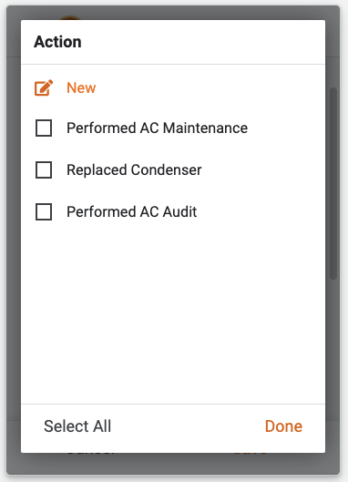

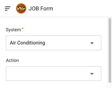

Here's what I get - see below - (1) the ACTION field has morphed into a different format even though it is still set to STACK; and (2) it appears to be filtering in some way, but it is returning options that don't make any sense (the three below do match ACs, but so do 3 others that aren't shown). What is odder is that I get the same three ACTION options if I select Furnace, and none of these apply to furnaces.

OK @Marc_Dillon - I gave it a try to the best of my (limited) ability. My ACTIONS table now looks like:

What is not working: Now, I've again lost the stack and I'm back to a choose-one drop down list.
If I change it to "Stack" in the screenshot below, it changes back to Dropdown when saved.
