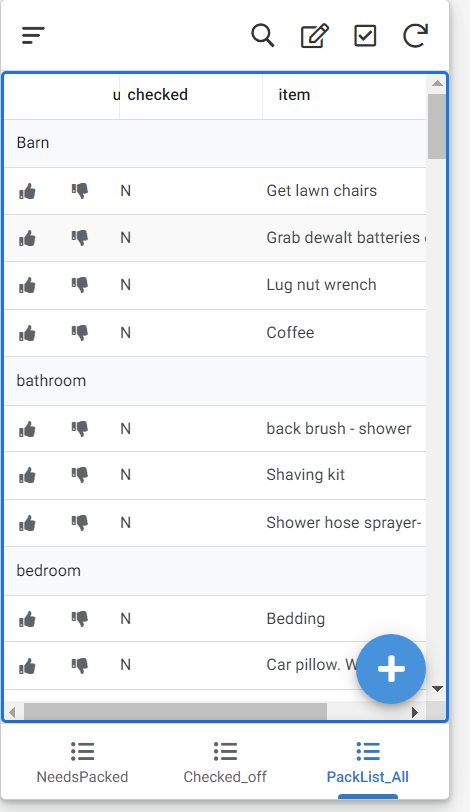

Hmm... Would you mind sharing some screenshots of your actions?
but what i need is a "Primary" button on the tableview, that resets all [checked] to "No"
I would like a primary button similar to the "add a record" (+ sign)  that will change all Checked items to NO
all rows,   the N = NOall rows, the N = NOslice of items packed  "Y"slice of items packed "Y"slice of items Not packedslice of items Not packed
I don't think you can have a primary button for that action on a table view. You could use a dashboard with 2 views to workaround this. Screen Shot 2024-04-19 at 9.21.39 AM.png
