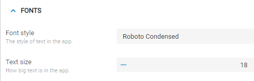

I want to add - i have changed the font size to the lowest it will go - “18”

Hi @Tiger Have you tried the smallest Font “Roboto Condensed”?
