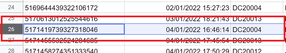

The reason I ask is that the number is not coming across correctly - it MAY be related to the fact that there is a formatting formula on that cell in Google Sheets. Appsheet picked it up as a number type. If I change the field type to text looks ok, Hence the question.

I took the field and formatted as a number in google sheets. Regenerated the structure just in case. On closer inspection the number is just wrong - it has most of the number correct but the last few digits are incorrect.
I think it IS a bug…
I checked a few other numbers - it is rounding (up/down) based on the last 3 (in some cases 4) digits…

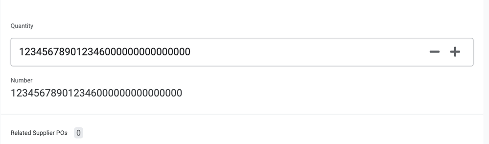

I happened to check this out on a View where I had a QuickEdit set…and the value showed correctly in the QuickEdit.
Below is view where I have 2 columns set as Number with the same exact value - one shown as QuickEdit and the second is not.
If I add 1 more digit…
Also, if I switch to Decimal…

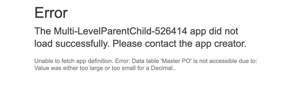

I went very large on a Number and never received an error message.
