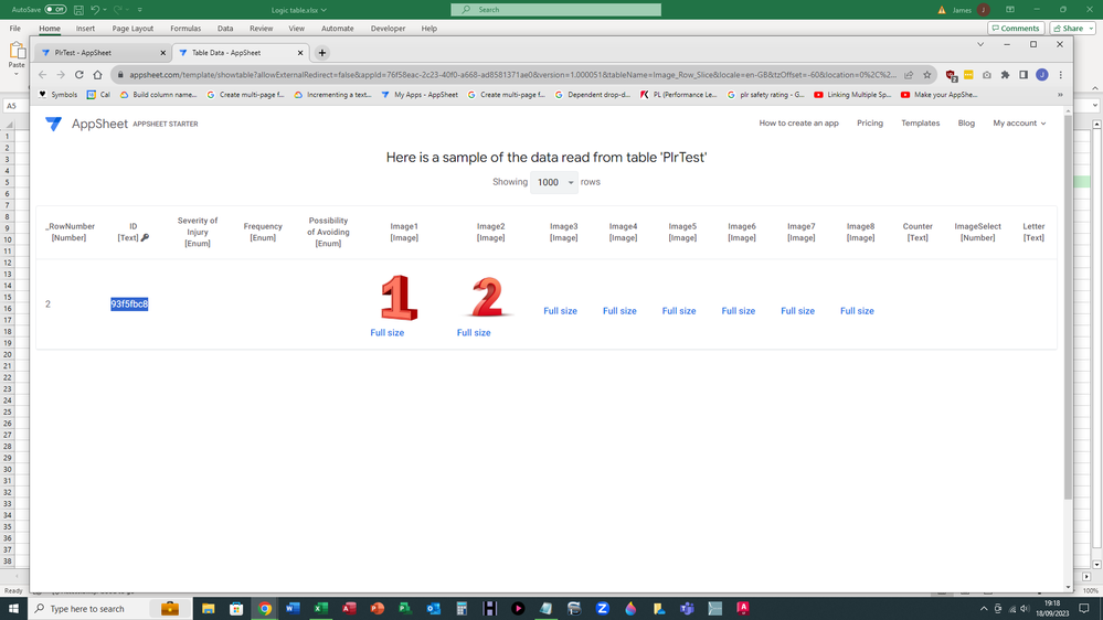

Here is a pic of the data preview in the slice.

Further to this, I imagine what's happening is that a slice doesn't store an image, only a reference to that image?
