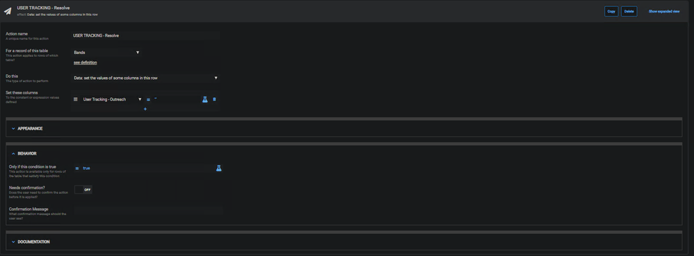

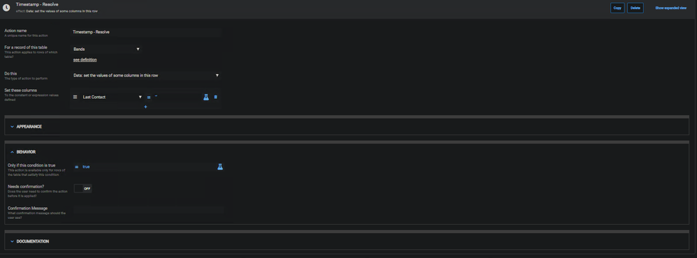

Nothing in your screenshots gives me any concern. How about screenshots of the actions invoked by Resolve - Grouped - Clear Data?
Invoked Action 1:
Invoked Action 2:
Invoked Action 3:
@Steve Hereโ€™s some screen shots of those three invoked actions!
Iโ€™ve had problems similar to yours when a Data: set the values of some columns in this row action attempts to set a single column value to its current value (e.g., set a column that is already blank to blank). The work-around I use is to use Only if this condition is true to verify the current value is not the new value.
