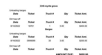

How do make sure a start statement always begins on the next page?  I am okay if second page is mostly blank, but its important that next statement creates a new page for each row. See example that I have now, I need the Project Name and Jobline name to appear on same page as image:
SANDRALAICHE_1-1661116704375.pngSANDRALAICHE_2-1661116801556.pngSANDRALAICHE_3-1661116952018.png

I have another question, I am trying to have the ticket info "group by" Project name, then by jobline, then list the ticket info, I thought I had it figured out but it so happened that the invoice I was testing only had one ticket per project and jobline, so it didn't look right when there was multiple tickets per jobline.  Here is what i want it to look like:
or this
You can incorporate Grouping like you have illustrated.  There is no AppSheet included function to help so you will need to build it yourself.  Not difficult to do but there some "gotcha's" to explain.

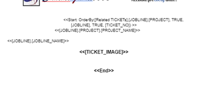

This looks exactly, what I need, one question, can the table in the filtered expression be the [Related TICKETs], or should I just add the additional condition in first filter statement to only select the [TICKET_ID] that are in the [Related TICKETs] ?? The information I need to "group" is all in the "Ticket" Table, but I only need the rows that are related to the current invoice I am generating.
Without knowing more about your schema, you can replace FILTER("NameOfTable" with START([Related NameOfTables][id_column]

OMG, I spoke too soon, can you take a look at this and tell me what I am doing wrong, its so close, but yet so far away, lol:
Since it's already inside another Start
