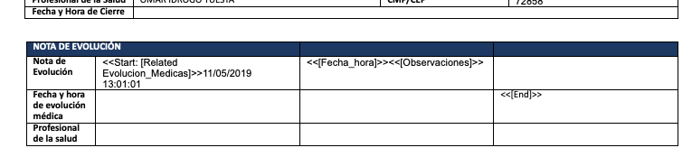

I´m having troouble with a Related expression in a DOC for a workflow template:
The only data that is showing is this: <<[ID_Fecha_hora_AT]>>
The other data is not showing, just showing the expression in the sending email.
<<Start: [Related Evolucion_Medicas]>><<[ID_Fecha_hora_AT]>>
<<[Fecha_hora]>><<[Observaciones]>>
<<[Firma_medico]>>
<<[End]>>
0 1 644
Two things:
  1. Remove the [square brackets] from the <<[End]>>
  2. Put it on the same line in the table as the <<Start:
Two things:
